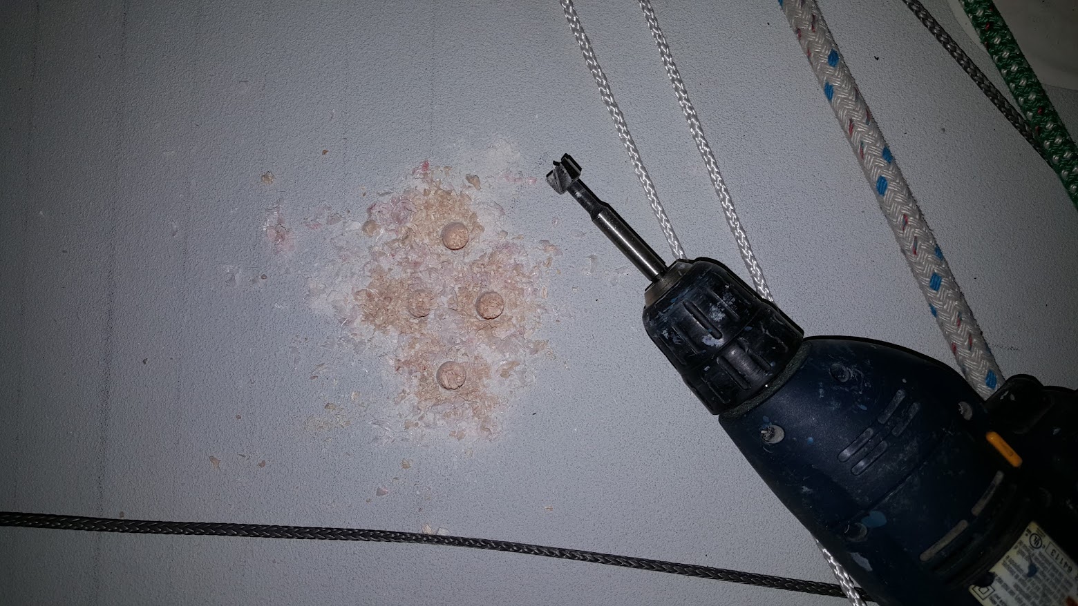

Center of padeye located and pilot holes drilled in top glass layer, through the balsa core but not through the bottom skin. The padeye center is located just inside a 6 degree angle from the centerline (measured from the forestay attachment point), and inline with the port and starboard chainplates.
Forstner bit used to drill out balsa core without penetrating bottom skin. The final hole size will be 9/32" to handle a 1/4" diameter screw. The Forstner bit is 1/2" which leaves a 1/8" epoxy isolated wall around the screw hole.
Epoxy was thickened with colloidal silica and poured in the holes. A heat lamp allowed thickened epoxy to cure with outside temperature at 25 degrees. Once the epoxy cured, the area was sanded and 9/32 inch diameter holes drilled with the top countersunk so that a good seal could be made when the padeye is mounted. White gelcoat was screened on to seal the epoxy and cured with heat lamps.
