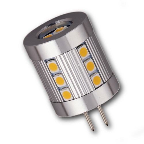

I bought LED bulbs from Marinebeam to replace the Halogen bulbs in all the internal lights. They have internal voltage regulators and may be dimmed. Unlike the cheap chinese knock-offs you can buy, these do not use dropping resistors that may actually burn up and cause a fire. They are brighter than the halogen bulbs they replace, have a nice "warm white" color and draw significantly less current.
Reading Lights: 9-LED Back Pin G4 SMD Power Cluster Novi (BP-G4-09X) - Warm White
Dome Light White Bulbs: 21-LED Ultra Bright G4 Replacement (AL-G4-21-WW)
Dome Light Red Bulbs: G4 LED Bulb 15 LED SMD Mini Tower (TW-G4-15-RED)
