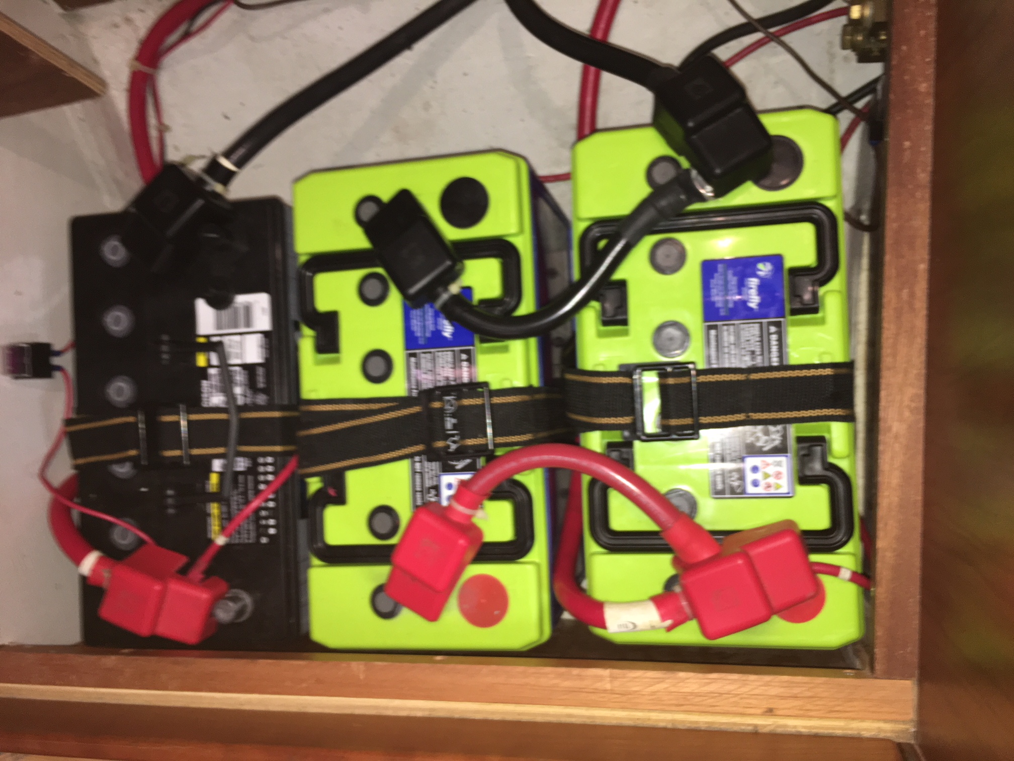

I was able to fit two Firefly batteries in the stock location. I am running one regular Lifeline AGM as a reserve and two Fireflys as the house bank. The Fireflys will fit if you put them in the aft two locations. Then I changed the positive wiring to retain the 1 BOTH 2 positions. The Fireflys have a lot of capacity. So far we are very happy with their performance. Excuse the blurry pic.

Note that the house batteries wired in parallel as pictured above are done incorrectly. Putting the boat leads to one battery and then piggy-backing two off to the second battery will cause a small, but critical, voltage drop to the second battery. The charger will slightly and then eventually continuously over-charge the first battery, damaging it. (This happened to me: charger started running constantly, first battery was bulging, quite warm and held no charge, second was fine.) It's best to put one boat lead to each battery to keep the voltage levels identical. There are detailed treatises on this topic online.

The previous owner had problems boiling batteries. Mine are hooked up the same way as your picture when I run all 3 batteries. Normally I only keep two on the boat (Group 24 AGM start battery and Group 31 AGM house battery with 2nd Group 31 AGM in parallel when cruising). I set the charger and voltage regulator properly and installed a temperature sensor on the center battery (see this old post). I've never had a problem and am getting good battery life.
