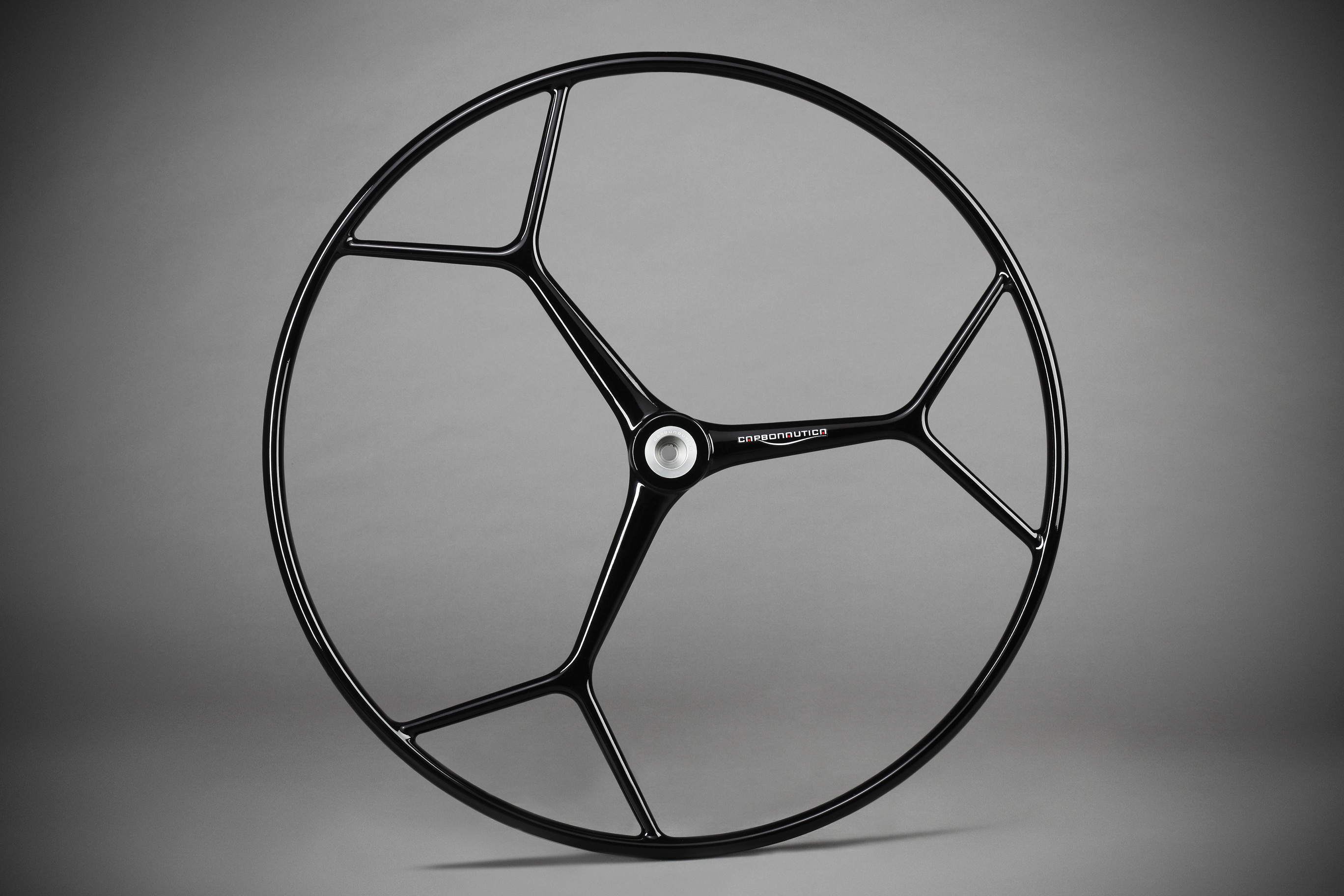

Brennan Hale from Bristol Yacht Rigging who was the individual who contacted me originally just sent the following information about the Carbonautica Wheel used on some of the European built J/109s along with photos.
From: John at Carbonautica
Sent: Thursday, January 28, 2021 4:29 PM
To: Brennan Hale
Subject: J/109
Hi Brennan,
Thanks for your enquiry- we have supplied the j109 with a 1500mm wheel here in the uk before.
It’s available in a glass / carbon painted version ( $2640 ) - 4kg
- and in Clear Carbon ( $3570 ) - 3.2kg
The wheel is legal here in UK as it doesn’t directly increase the speed of the boat. Unfortunately I do not have any official info for the USA - however - as it doesn’t directly increase boat speed only handling and responsiveness compared to the steel wheel- it may be ok. (there is a significant weight saving between the two wheels but not significant in relation to the boat weight overall.)
Wheel despatch is 4 weeks from receipt of funds.
Delivery is as per Dhl / fedex best rate.
If this offer is of interest please advise and I’ll get a quote ( $300 max approx )
Best, john
Further to my last mail - here are a couple of pictures of the wheel - also comes standard in white and grey. We can custom paint as well. Any solid RAL colour. ( not luminous or metallic though)
- IMG_1589.JPG (907.78 KiB) Viewed 37608 times
- IMG_1714.JPG (339.94 KiB) Viewed 37608 times
