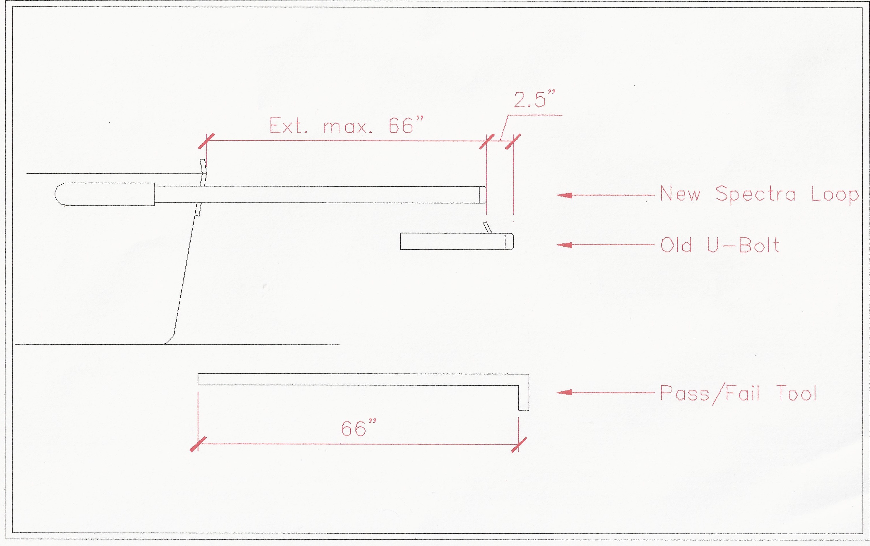

What is NOT class legal is the approximately 2.5” of additional horizontal extension of the vertical bearing surface for the tack line this new design will result in.
In a sample of boats of various age, with the various end cap designs, all but one was found to extend the vertical bearing surface for the tack line up to 5 1/2 inches past the specification/class rule of maximum 66”.
In order to bring the class into compliance with this rule, the maximum extension should be measured and the rubber bumper preventing forward extension of the sprit moved accordingly. A second bumper may be added to the sprit or forward bulkhead. If a boat fails inspection before a regatta a temporary stopper line run parallel to the shock chord is allowed.
A pass/fail template will be made to help check the maximum extension of the sprit/tack-line. This tool may also be used at class events to check for compliance
For a printable drawing, download this pdf file.
