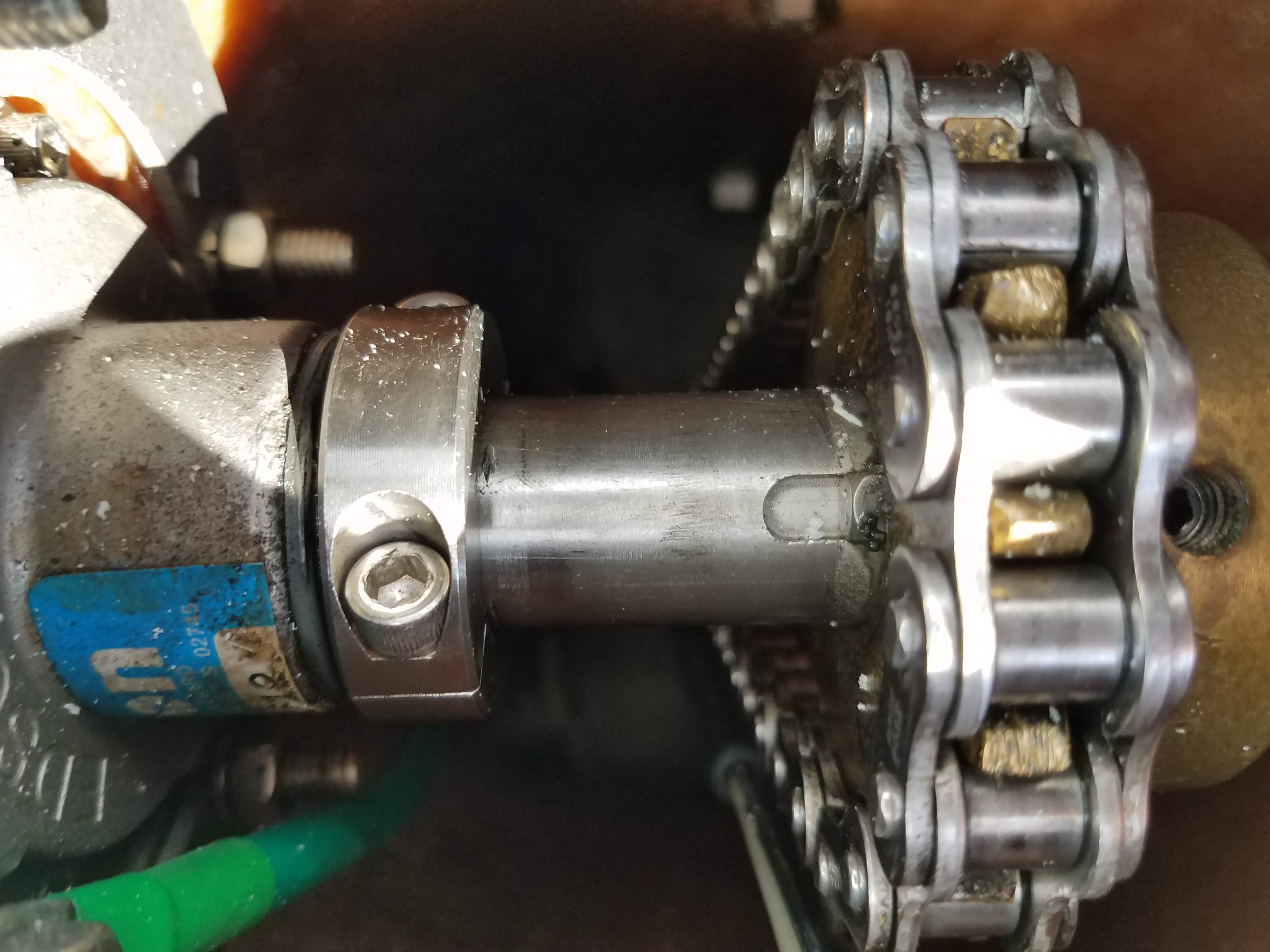

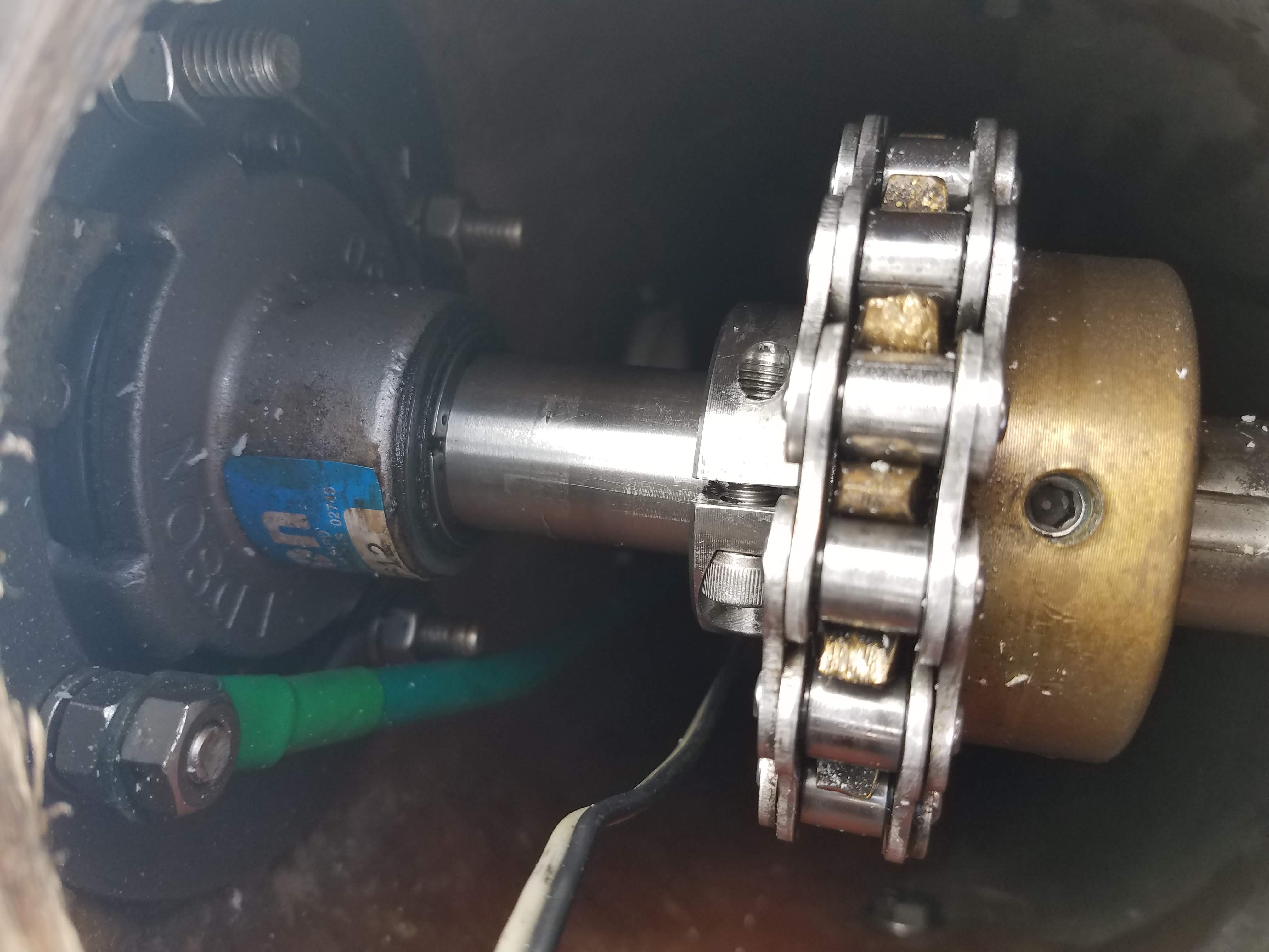

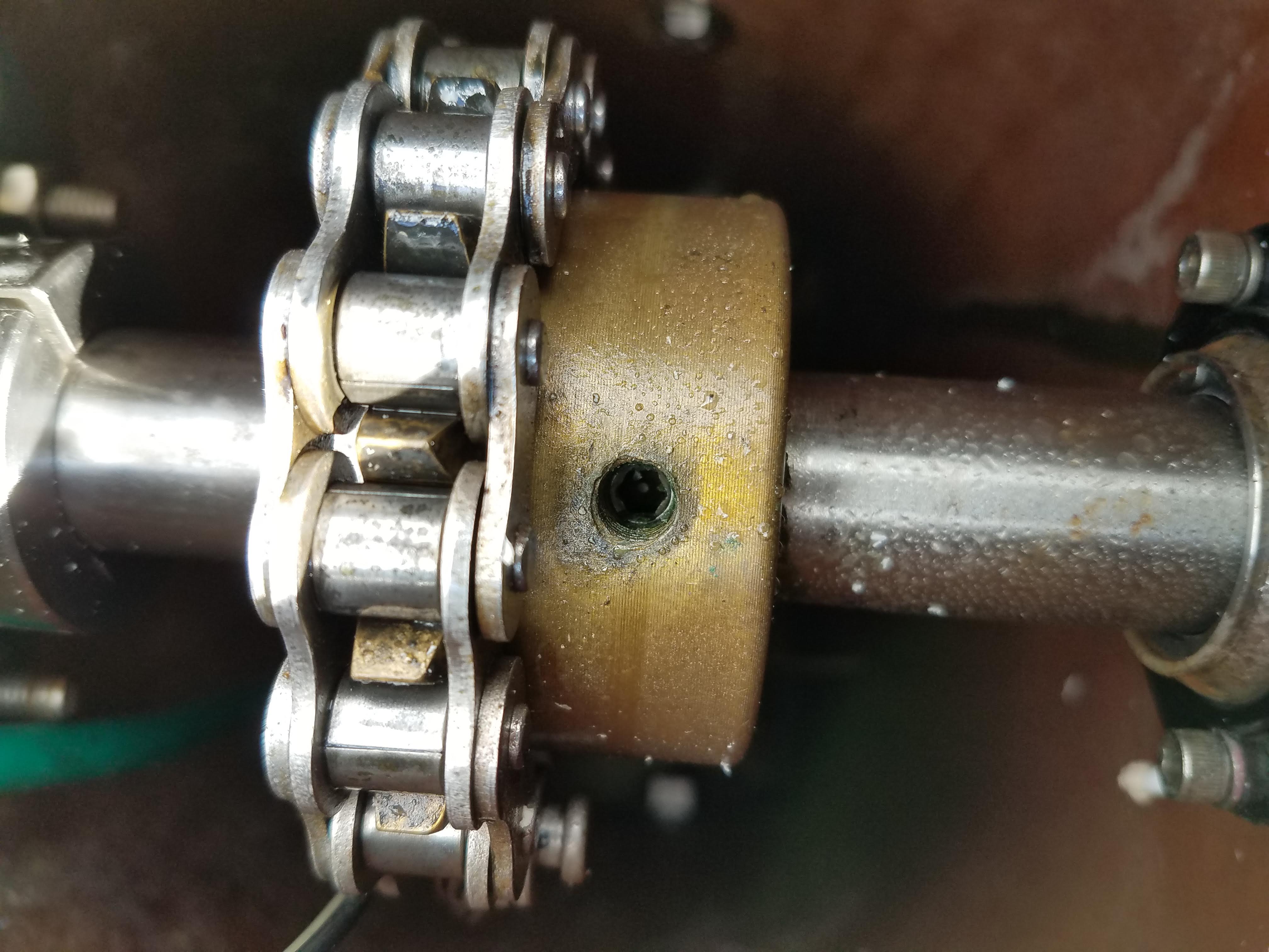

The helm lock on #261 has been operating poorly. I worked with Edson to troubleshoot. Below are some pics of what is going on in there. Things to check: (1) is the snap ring sitting in the groove on the shaft; (2) is the two-part collar up tight against the snap ring; (3) are sprocket hub set screws in place and tight. We still have not figured out the problem. Edson is now recommending replacing the brake shoe: https://edsonmarine.com/brake-kit-for-4 ... -steerers/
Snap Ring.jpg (401.28 KiB) Viewed 14890 times
Collar in Place.jpg (433.71 KiB) Viewed 14890 times
Set Screw.jpg (742.18 KiB) Viewed 14890 times

While I would be interested in what you finally figure out, your last photo on the left of the sprocket appears like one of the pins in your chain isn't as flush as the others. Might be just something from the photo, but it did catch my eye. Even though its unrelated to your issue, Edson does sell replacement chain+cable.
Had no idea that there was an actual brake shoe in the hub. When I spoke with them last year they just mentioned adding the collar nut against the split ring and lubricating everything with Teflon spray.
Was planning to take that whole assembly apart this winter to re-grease like I do with winches as overall motion in mine doesn't seem as smooth as it should be. Will take photos when I have it apart.

I also noticed that pin and found it was just the angle of the photo.
Edson informed me that the brake shoe is aft of the pedestal in the assembly between the wheel and the pedestal. I was also told that they could provide no further assistance because J Boats made the pedestal, and that I should contact an approved technician. So no resolution, yet.
