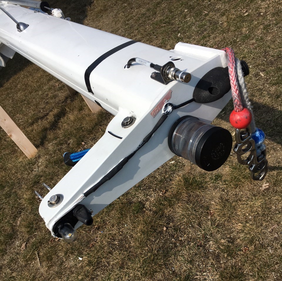

Never replaced the main sheave but pretty sure the last time I had the mast down for VHF maintenance it can be done through simply and very carefully removing the clevis pin. Mine is a newer mast though, so unsure if there are slight design differences (shouldn't be). There is a handy manual from Charleston Spar (in the manual section) that should should show this is removable. Bill can confirm (sorry to hear about that storm damage, Bill).

Yes, I replaced them all last year while they were laying flat either by removing cotter pins or in one case I think there was a little metal door that screws off/on.
It is a little difficult removing the sheave. We lost a sheave in the mast, where it stays to this day.
The only prep, is to replace the halyards with tracers before you get started, not sure if that was necessary but it is a good idea to not have to deal with the lines.
