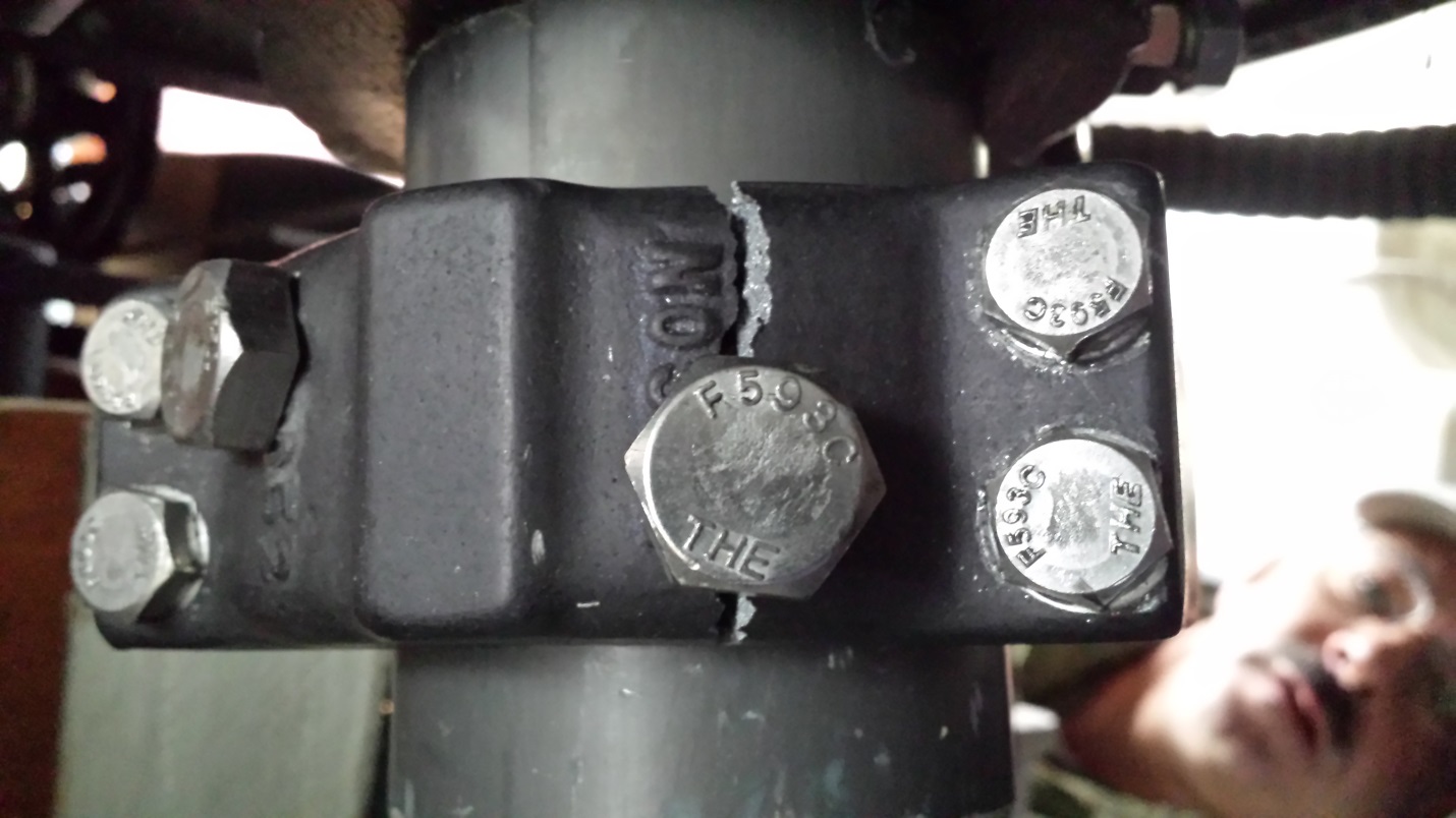

All - another great thing to check on is the back of your rudder post where the auto-pilot tiller arm connects to the post. I found a crack and need to replace it.
You will need someone small to get behind the rudder post, or have a selfie stick to take a picture behind there.
See page 35 for J Boat tiller arms, and the tech tip on page 65
