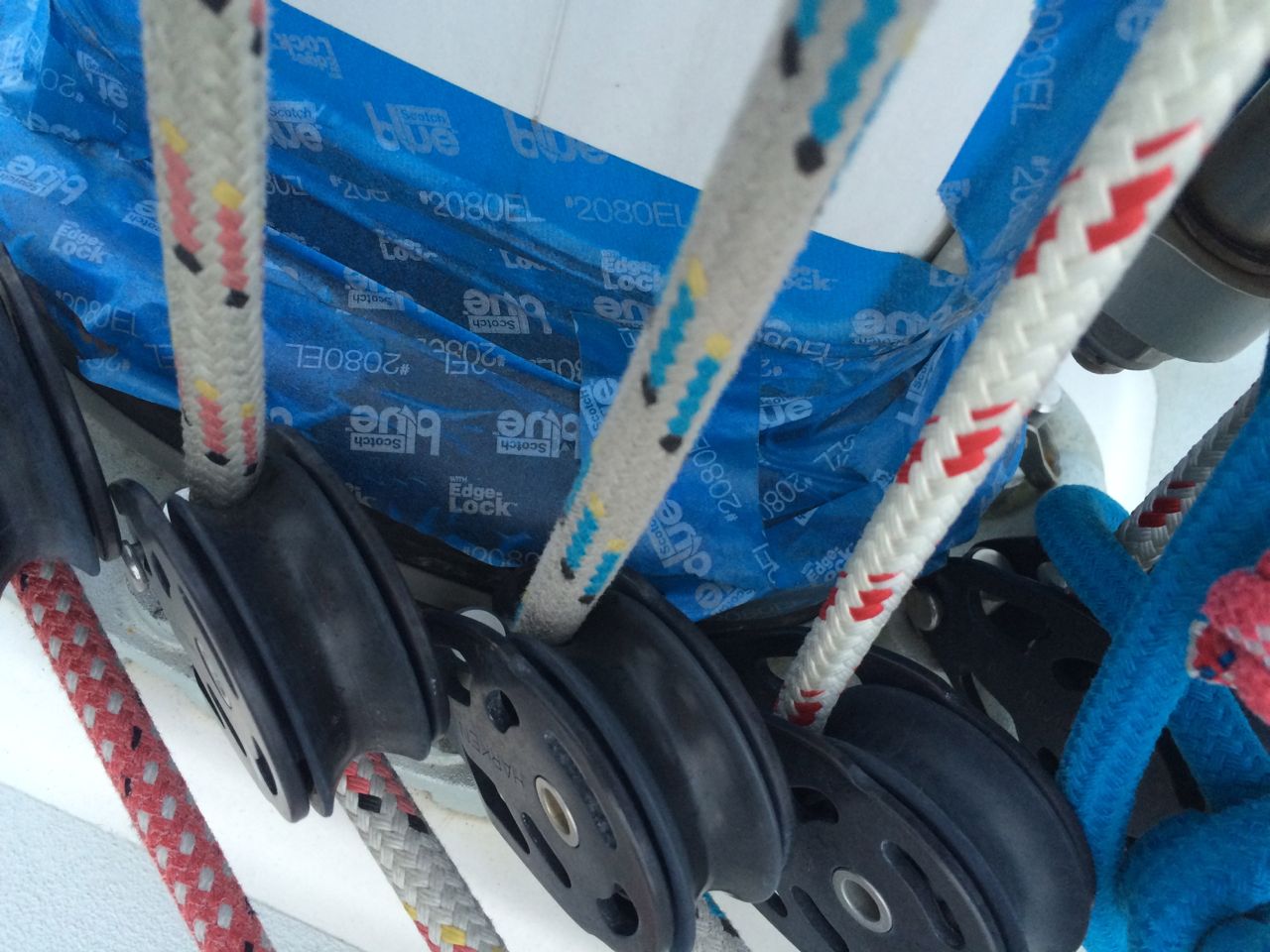

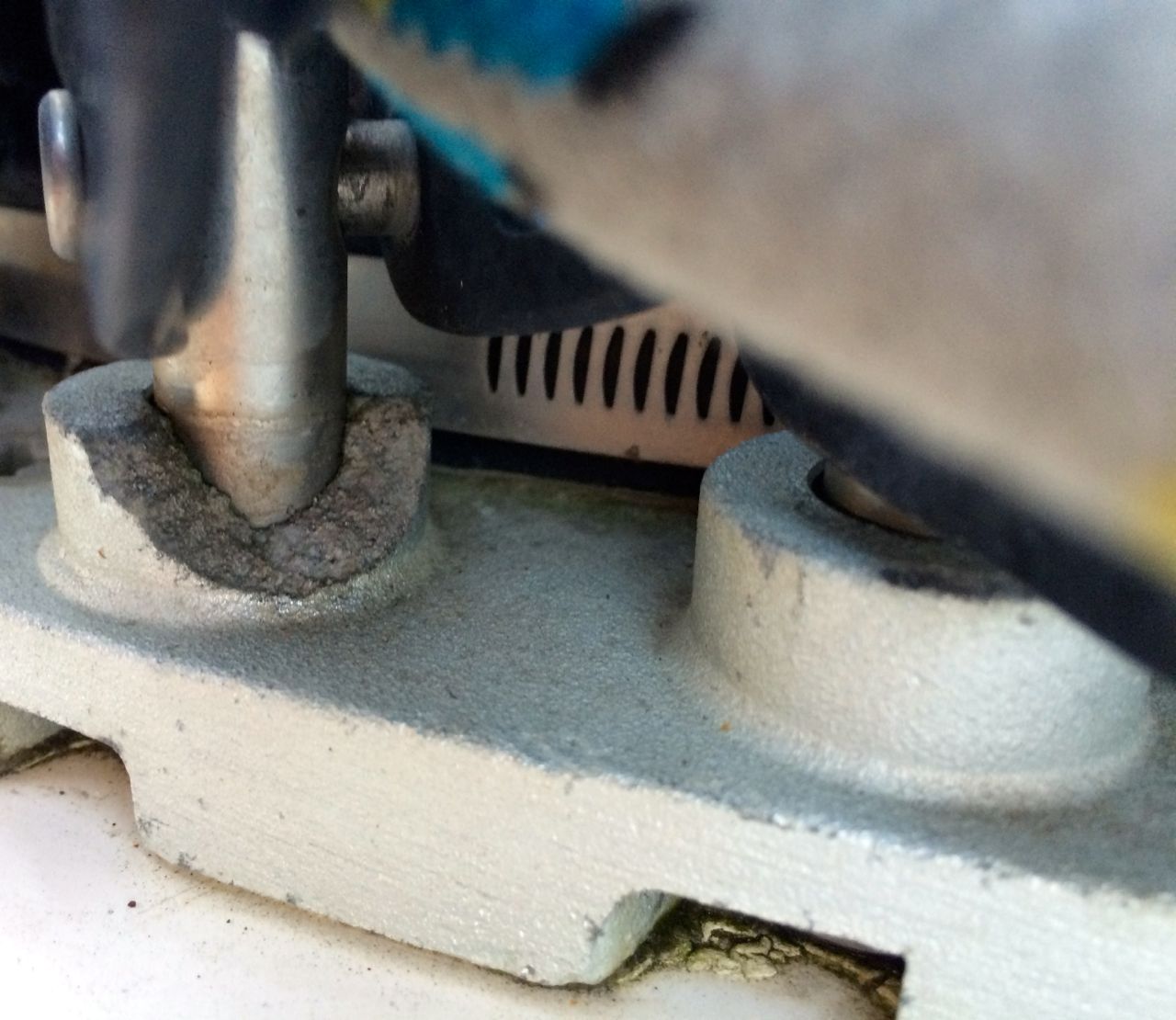

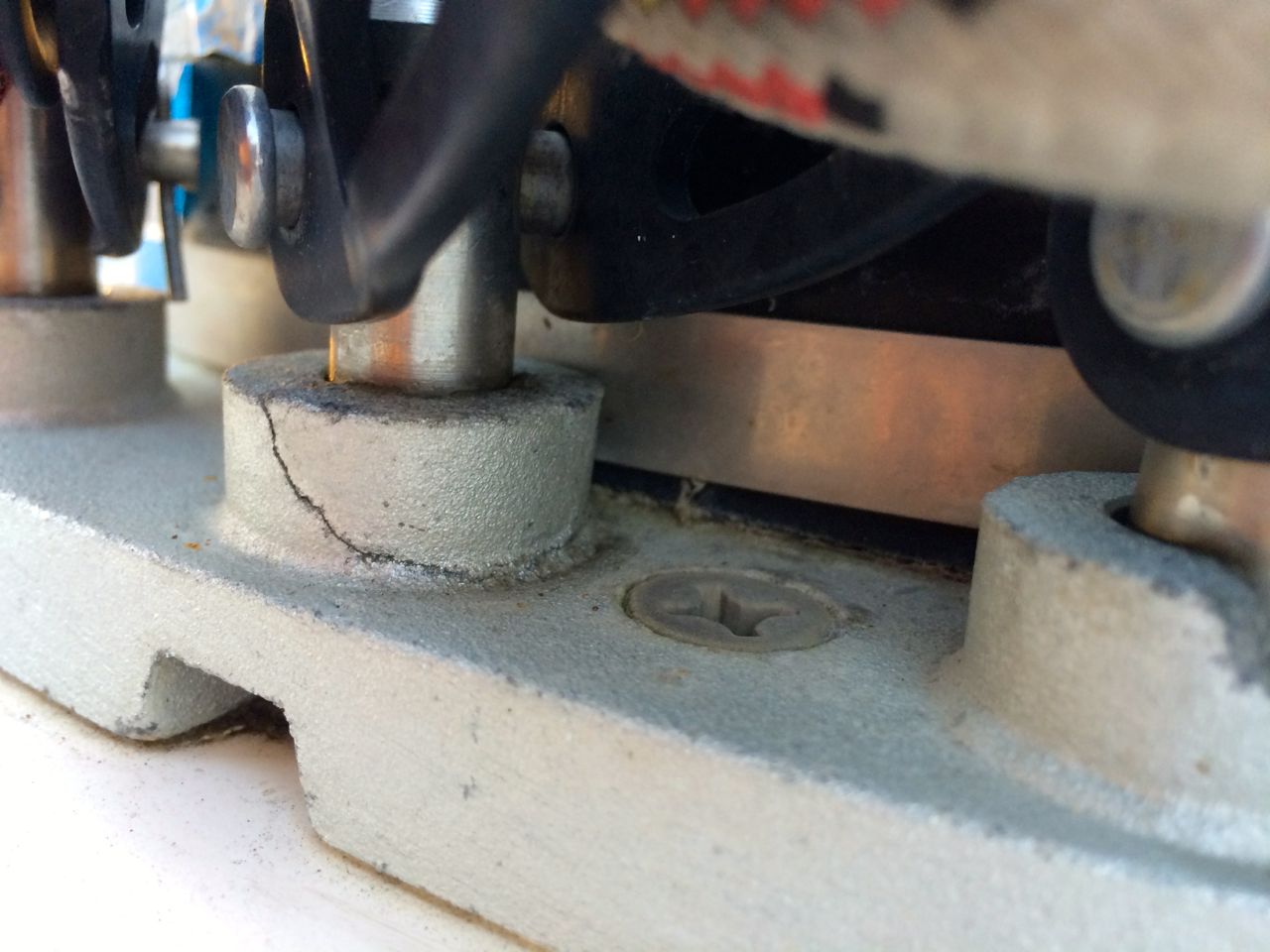

Has anyone had their mast collar crack around the turning block pins? I have a (new to me), 2004 J/109 #195 (iirc). The two cracked joints in question are, of course, the blocks for the main and jib halyard. Am I doing something wrong, or is this an expected maintenance item?

Yes, I had this same problem. One of the turning block pins were bent too. This is the first I have heard of anyone else having this problem. I have a 2005, hull #203.
I put the turning block pins in other positions in the mast collar for the rest of the season (not the best angle for the lines, but it worked). When I had the boat hauled at the end of the season, I had the mast unstepped and replaced the collar. I ordered it from Waterline in Rhode Island. They have never heard of the mast collar cracking either.

I have Hull 105 also located in San Francisco and upon inspection today also saw evidence of cracking on one of the tubes which houses the main halyard turning block pin. Strange that this seems to be a San Francisco phenomenon.

I have hull #148 - major crack across whole of collar - does anyone know where a replacement can be purchased?
