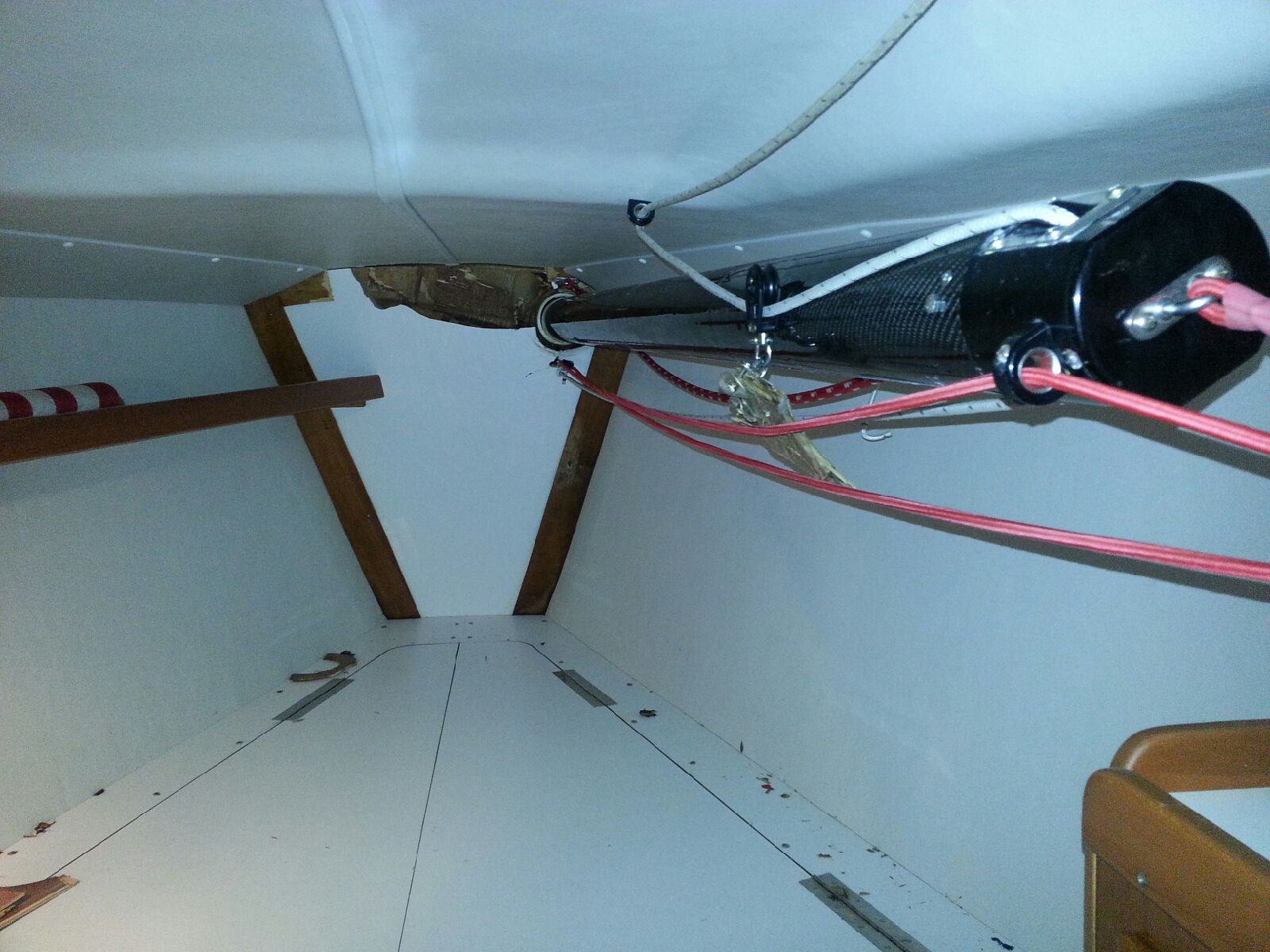

One of my crew was sailing in a double handed race on J/109 Strider in May. They ended up having to retire early due to a broach that rounded them up with the sprit extended. This put significant load on the sprit retrieval line causing the attachment padeye to pull out of the forward bulkhead in the v-berth. It ended up doing significant damage to the bulkhead.
Damage to Strider's Bulkhead

Oversized Padeye with 1/4"-20 attachment hardware
G10 Plate, Padeye and Turnbuckle Attachment Inside Anchor Locker
Wichard 6361 Eye nut attached to existing stem head fastener
View looking into anchor locker shows completed bulkhead strengthening on right, and bob stay retrieved with bungee cord on left
