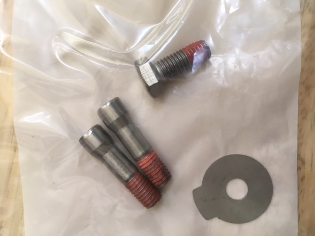

When you replace the seals in your lower sail drive every two years (or if you take your prop off for other maintenance), you should replace the prop washer and locking screws.
If you have the flexfold 2 blade https://j109.org/docs/flexofold_install ... 0_2013.pdf, here is the place to order the parts from and the part numbers:
Hansen Marine Engineering
32 Tioga Way
PO Box 1106
Marblehead, MA 01945
781-631-3282
FF-Screw: Locking screw tappered M8x25 D (Qty 2, $10.45 each)
FF-Tab Washer: Locking Tab Washer (Qty 1, $5.50 each)
FF-V1007: Locking screw M8x20 mm (Qty 1, $4.95 each)
prop washer.jpg (69.63 KiB) Viewed 9800 times

What Brooke posted is the same as I have on the new Flexofold prop I have after the previous fell off while underway. Apparently, I'm not the only one to have this problem. I'll be replacing that washer every 2 years. Thanks Brooke!
ps - this is the lock washer for the nut / hex bolt combo that holds the prop body on the shaft, not for removing the blades.

Post by bmastror »
Correct Bill. This is for the nut/hex bolt combo that holds the prop body on the shaft. It is a key component to making sure your prop does not come off. Also the provided screws come with waterproof loctite.
