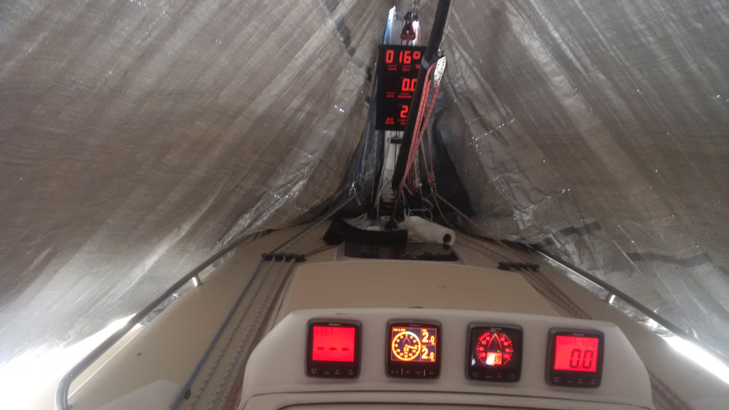

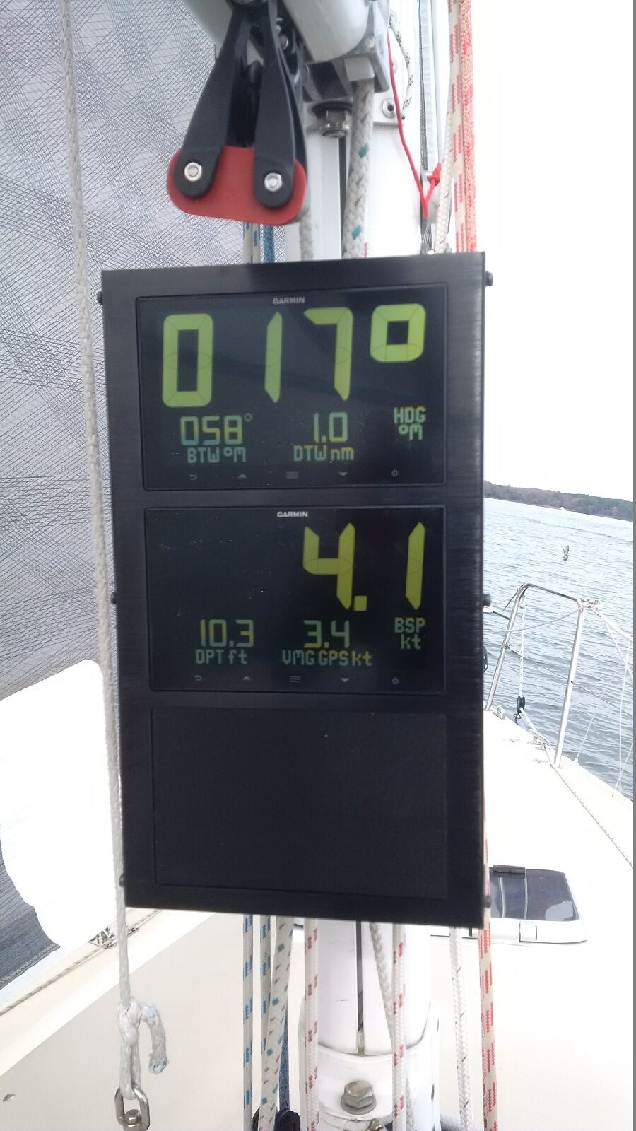

I don't know how or why but I never adjust the lighting on the Garmin displays. The lighting for the Garmin displays is always on and set on red and high. During the daylight hours the displays are a yellow/green color but at night they automatically turn to red/orange. I do nothing to them at dark. Don't know how to post pictures but I have both day and night colors.
Daytime Garmin Instruments
Night time Garmin Instruments
Re: Instrument upgrades
Those are very nice looking mast displays. If I had known about the "auto" back-light mode switching, I might have made a different decision.
