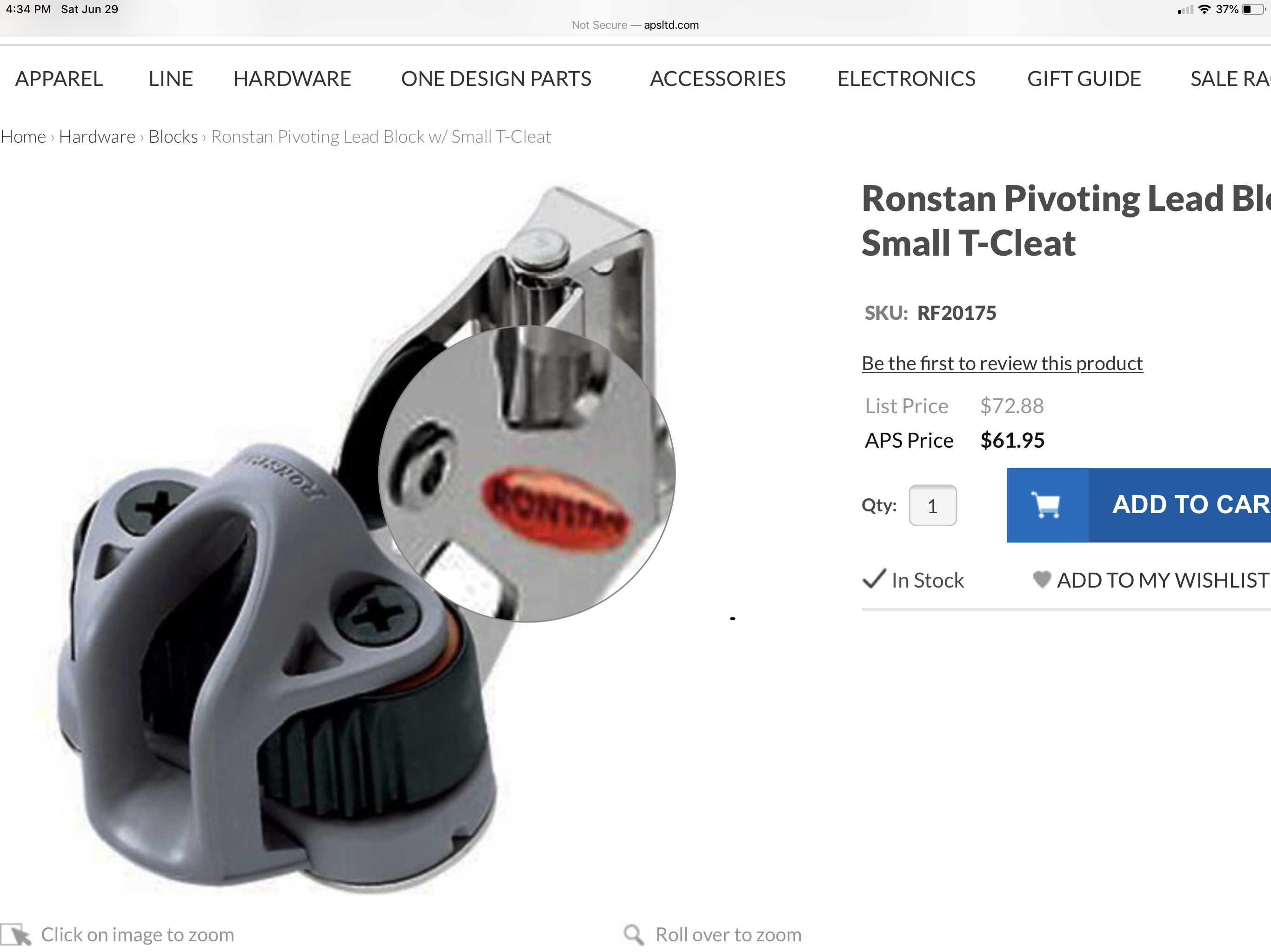

Mine wore out as well. Instead of replacing the clam cleat (that slips any way) I used the Ronstan dingy pivoting Lead block w/ small T-cleat (cam-cleat) http://www.apsltd.com/pivoting-lead-blo ... cleat.html
I took the lead guide off the cam cleat then tapped 2 screws about 6-8 inches aft of the current pulley, then mounted it under the boom. So the outhaul leads aft through the lead block then through the cam cleat. So far it is working even under heavy loads. I haven’t removed my old clamcleat or pulley yet, until I see if this dingy cleat will hold up. It outhaul line is at the maximum size. Harken and Ronstan do make a larger system if this fails, I just don’t know if the base will fit inside the groove on the underside of the boom. Right now I sail PHRF so I don’t know if this modification is OD legal.

Interesting. I initially assumed that something like this would be possible. But then, looking at various catalogs, I didn't see an obvious solution for mounting a relatively wide cam cleat into the very narrow channel under the boom.
A photo of how you mounted the cam cleat to the underside of the boom would certainly clarify things, if you happen to have one.
