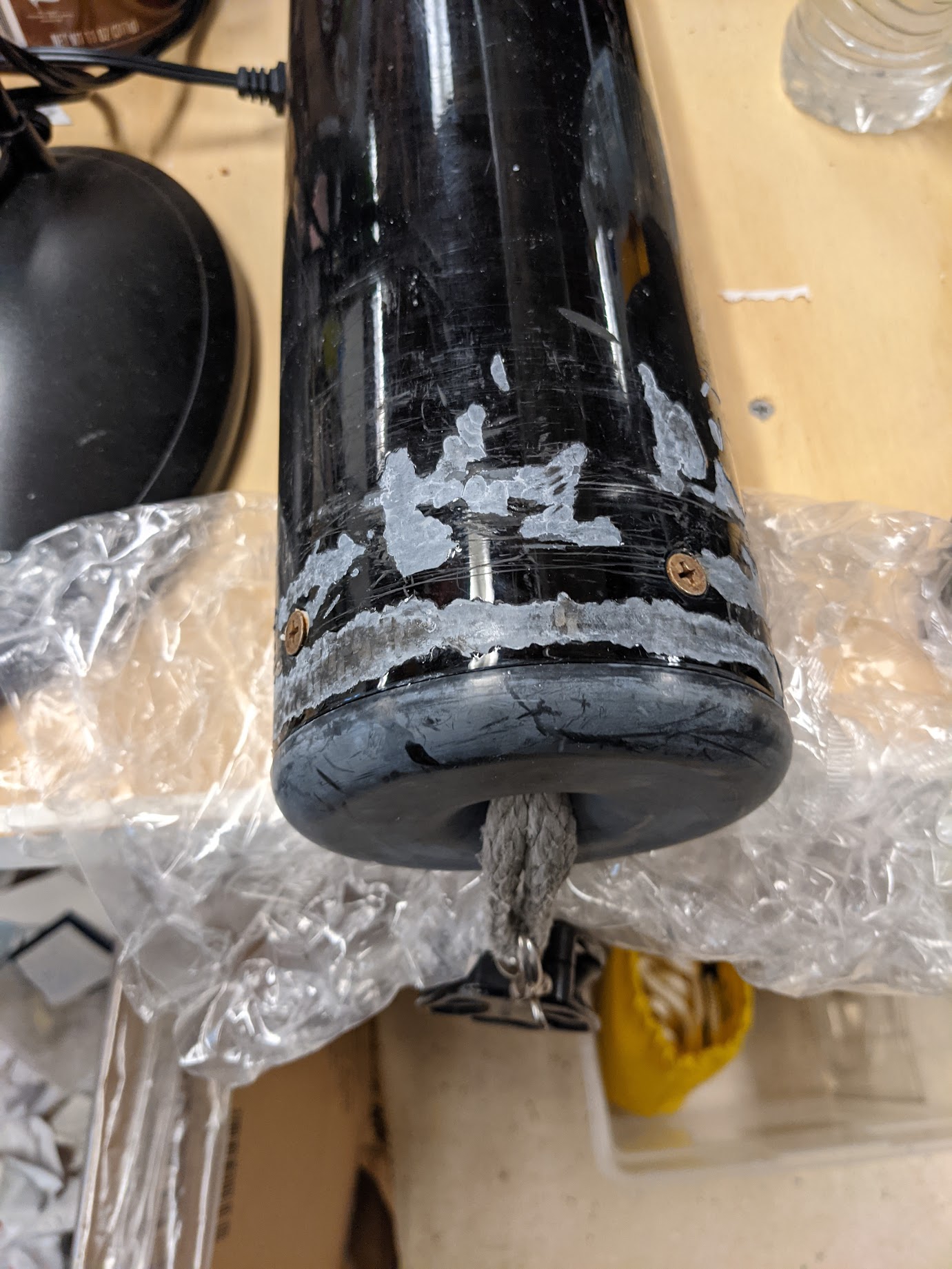

My pole is getting beat up by the block on the end. The pole was beautifully repainted last winter.
Any obvious problem here?

I've got the pole type that had the u-bolt and modified it to use an Antal ring instead because the block took chips out of the hull when the pole was retracted.
After having the pole repainted, I wrapped the end all the way around with 3" sticky Kevlar tape to provide chafe and chip protection. The tape end pieces are under the Delrin "sandwich" where the Antal ring is bolted to the pole (former u-bolt hole location). This stops it from peeling back. In your configuration, you may need a zip tie around the Kevlar tape to keep it from peeling.

What size Antal ring?
Re: Spinnaker pole question
I used the Antal R20.20
