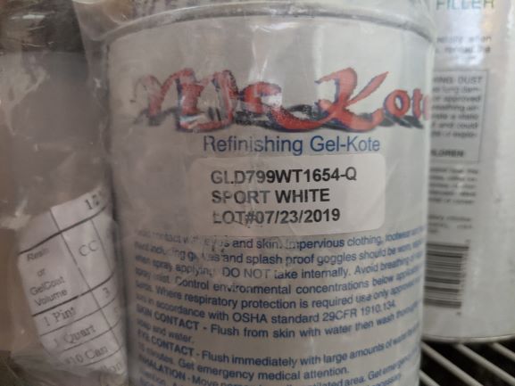

I purchased a quart from Mini-Kraft in Florida at this link. Get the kind with wax added so you don't need to cover it for curing. You enter the hull ID so they have the color matching available.

- gelcoat-label-compressed.jpg (35.88 KiB) Viewed 11656 times
