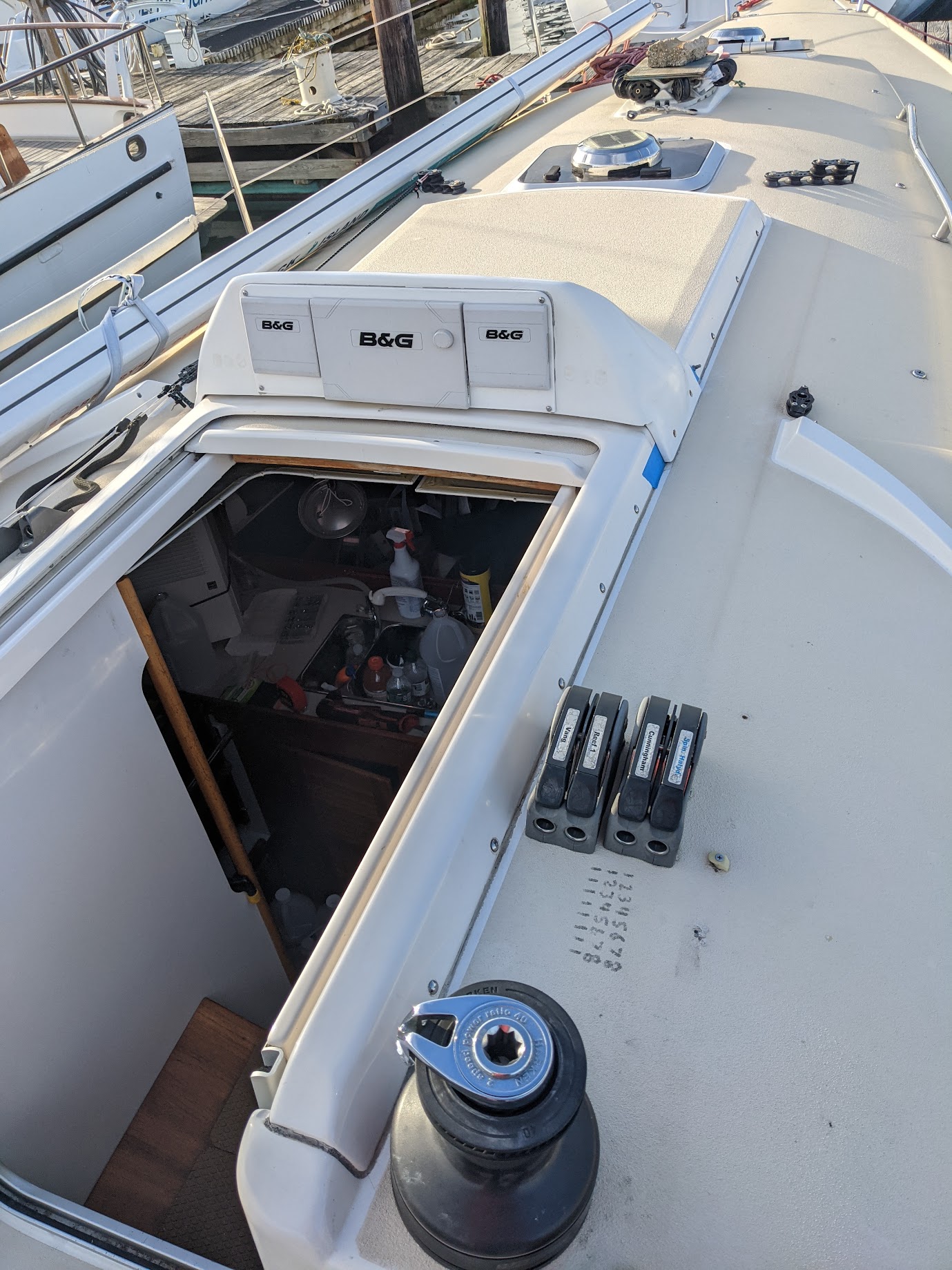

Re: Sealant replacement or maintenance?
Thinking of replacing the existing sealant.
Before I embark on this project, any advice on how to make the new seal look as good as the old?
