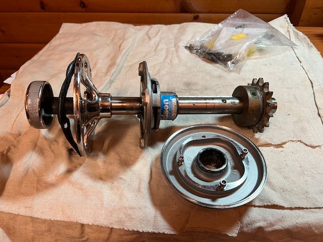

When I took the steering shaft out the front bearing fell apart on the deck, hens the play.
I then had a bit of a saga to get the right parts from Edson. They we very helpful, but clearly they don't have a record of exactly what went in each boat.
Anyway, the steering in my boat is a modified 420 Steerer with a 1" shaft and three bearings, instead of the more standard two. I have attached a shot with the front hub removed so others can compare.
So if yours looks like mine, the parts you will need for a rebuild are:
316-336-402-TSB Brake Kit for 336 & 402 Pedestals with Thru Shaft Brake
A third bearing not included in kit: 960-A-140-1 Bearing - Needle Bearing 1" - Stainless

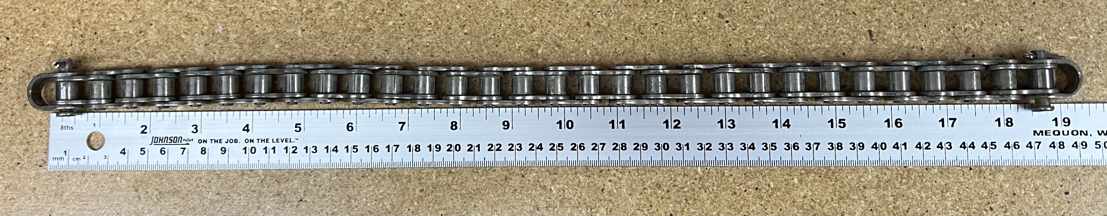

77400 CHAIN, 19" FT #50 W/SS CLEVIS EACH END & SHRINK TUBES
960-A-1979 Gasket, 420 Steerer, 1/16 Black Neoprene Duro 70 w/Lip
314-420 Steerer Rebuild Kit - 420 Bulkhead Steerers
