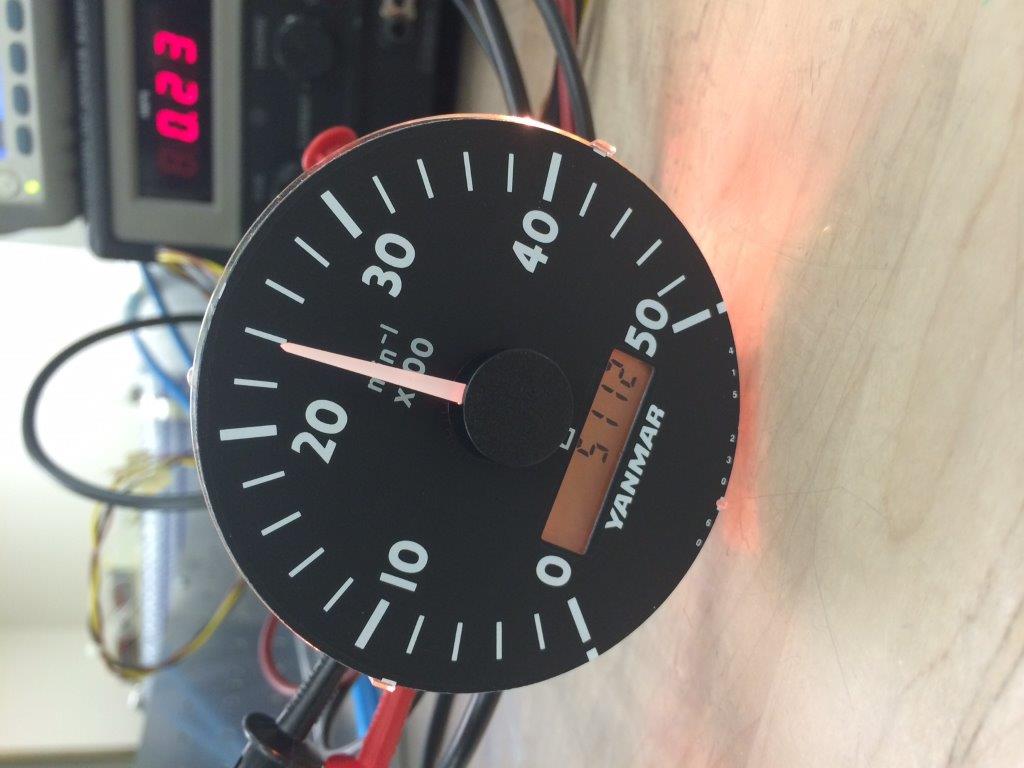

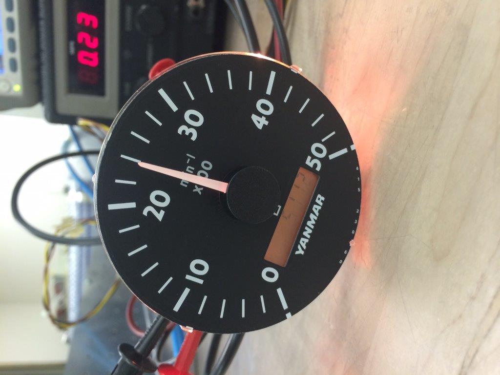

Thanks that worked. I was able to get the gauge apart and the old silicone cleaned out. The hour meter appears to have gone from working around 20% of the time to around 70% of the time. I left it on the test bench running for a while yesterday. I might mess with it a little more when I get a chance next week to see if I can get it working 90% of the time.
Hour Meter 3.jpg (73.55 KiB) Viewed 42979 times
Hour Meter 4.jpg (73.52 KiB) Viewed 42979 times
Here are pics of my hour meter working and sort of working.
