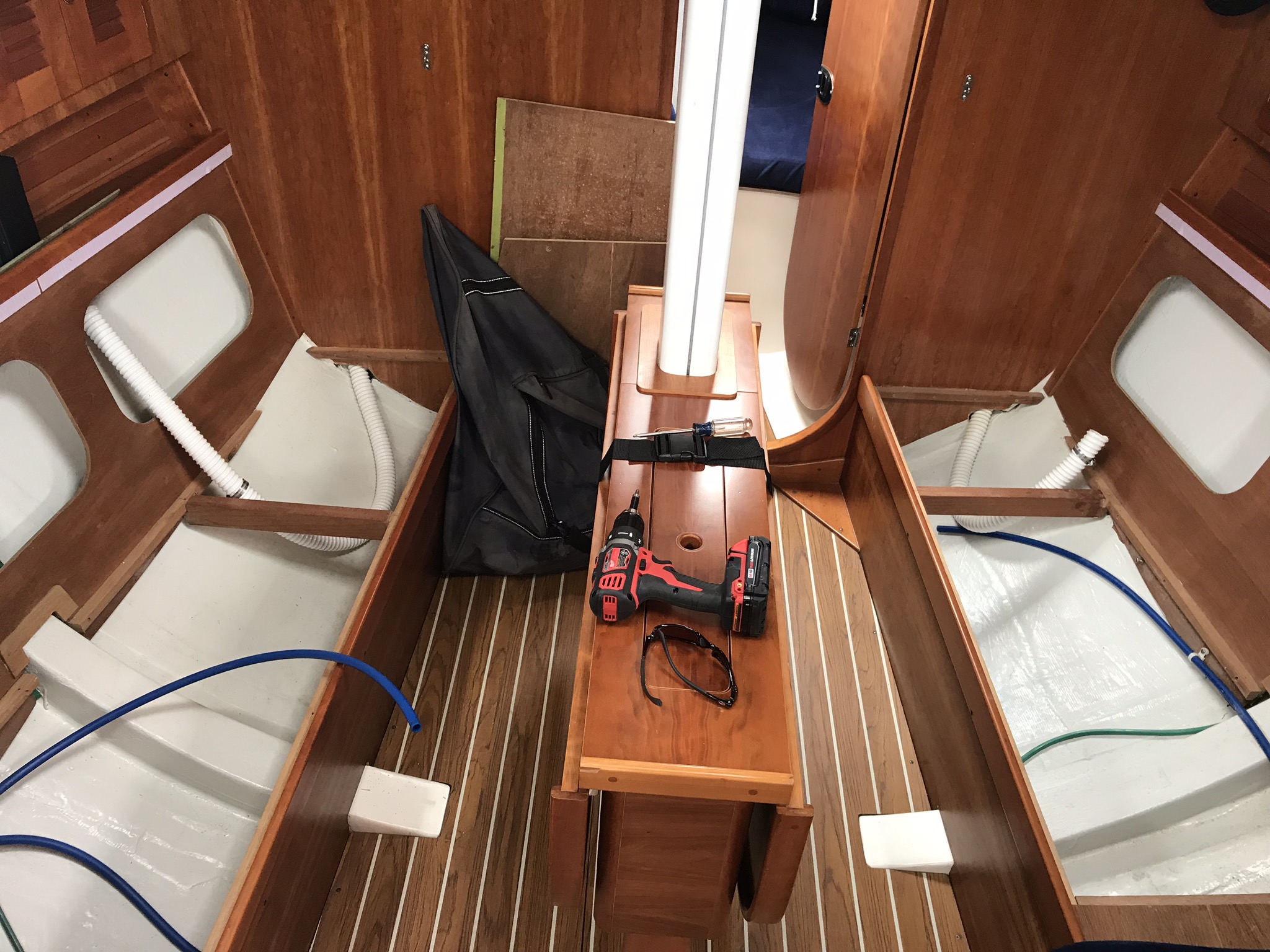

Re: water hose from deck to gland
Old bladders removed

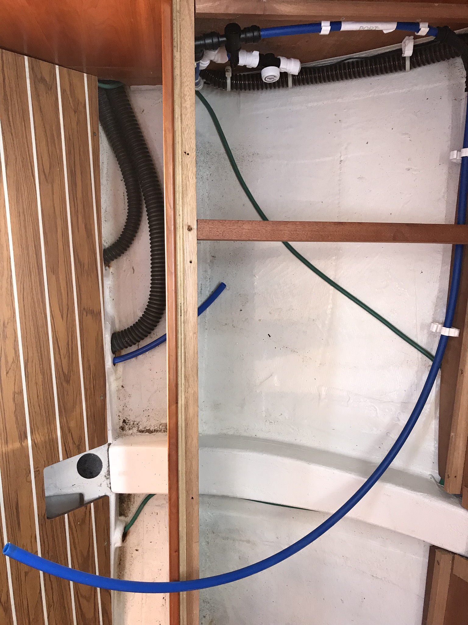

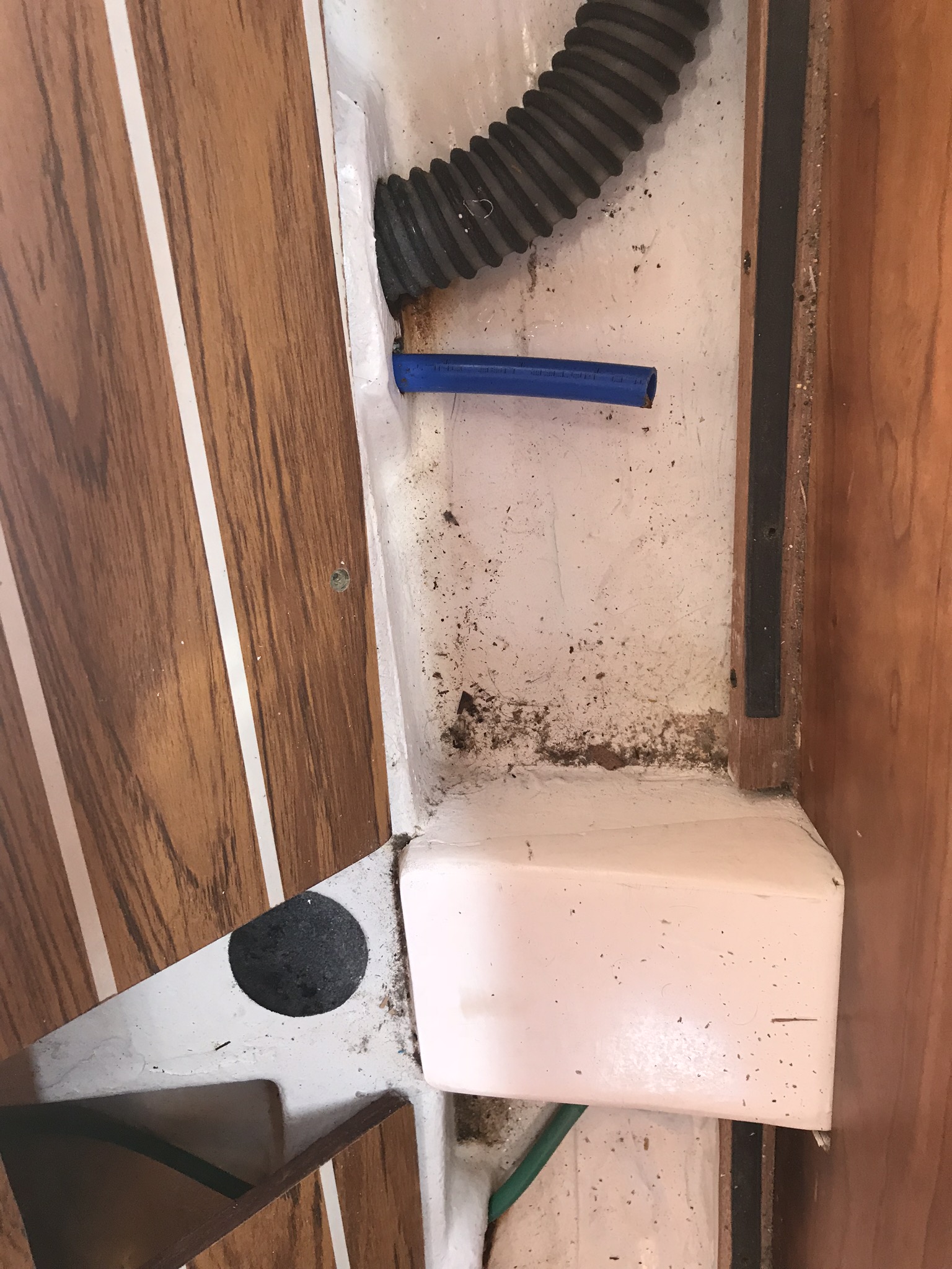

The port floorboards have to be pulled up in order to pull the new blue hose to connect starboard bladder to the valve manifold on the port side. In the case of my boat (#263) there is a post and nut in the bilge to which the blue water hose was zip tied to.

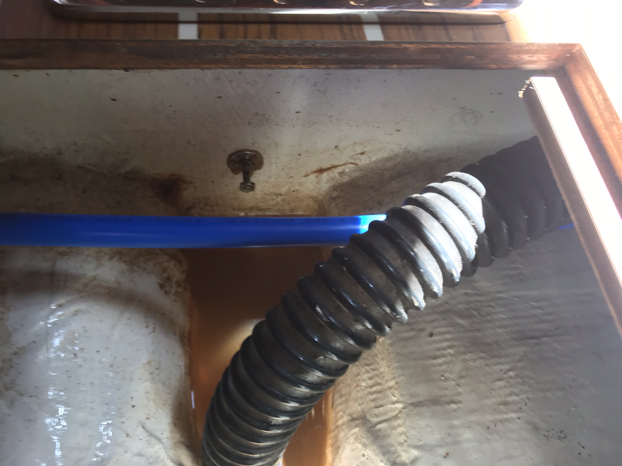

New hose going through bilge. Not the stud and nut. The blue hose will be tie wrapped to the stud and the bilge pump hose will be tie wrapped to the blue hose.
